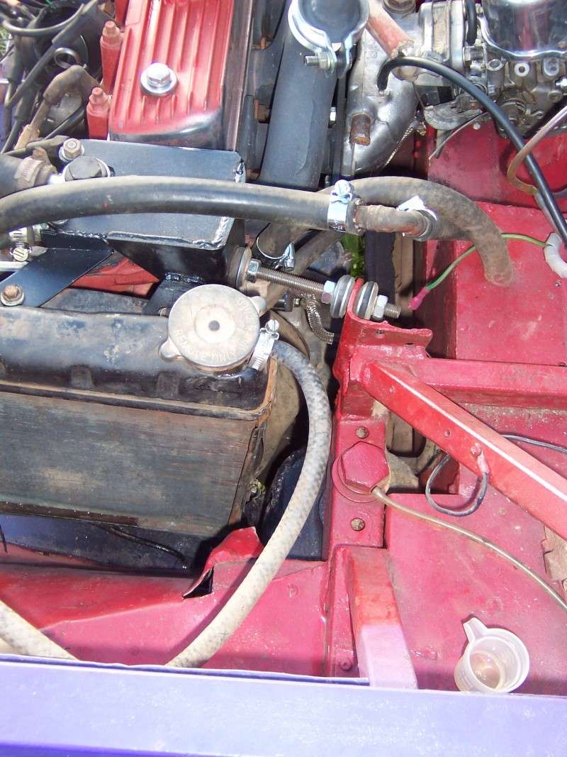

Post  Rum Tum Tugger on Mon Mar 03, 2014 8:19 am
As you can see, it has been done - sorry, can't remember who owns this Scamp.  I'd guess you'll have to make up a new set of solid spacers, and enlarge the centre hole.  The bracing, or some bracing at least, is a recommended mod on Mk2s.  The plastic tube attached to the bolt is, I believe, an experimental lubrication system that supplies WD40 under pressure to keep the bolt from seizing (IYBTYBA).

Post  Ferretboy221 on Mon Mar 03, 2014 8:27 am
^ obviously an adapted auto oiler system from a Touring bike...obviously study whistle

Post  TRR Motorsport on Mon Mar 03, 2014 3:21 pm
That photo looks Like Martin's Cyclops (upturned manifold with Chaz's revised steel inlet manifold extensions that tilt the carb at the correct angle.
Was it repainted Lilac by someone?

Post  SUMB on Mon Mar 03, 2014 7:46 pm
TRR Motorsport wrote:That photo looks Like Martin's Cyclops (upturned manifold with Chaz's revised steel inlet manifold extensions that tilt the carb at the correct angle.
Spot on James. I can also see the heat proof sleeving that I found to stop the throttle cable getting fried by the exhaust.
