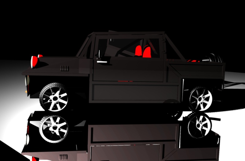

I've done a 3d model of the final look i hope to achieve (its a bit rough, but you get the gist i think)
The doors are going to be lift off, as yours is, but hinged at the back (suicide doors) The back end is being built up, to turn it into a pick up kind of affair, but with no back panel to the cab, as that is going to be part of the canvas roof i'm making.
I'm going to put a hinged panel that drops down in the back seat area, making the rear area flat, but when needed, it can hinge up and become the back seat (havent worked out a way of, when the seats up, it being rigid enough as yet)
Thoughts or suggestions?

I like the 3D model - do I need a pair of 3D glasses ? Those tyres will cost a fortune with a profile of 10.
Its about time someone digitised the Scamp perhaps it can be used in a virtual offroad game on PS3 so I don't get muddy?

Heh. The wheels are a little unrealistic but it is rough :-p
oh and I'll get right on that computer game :-p
