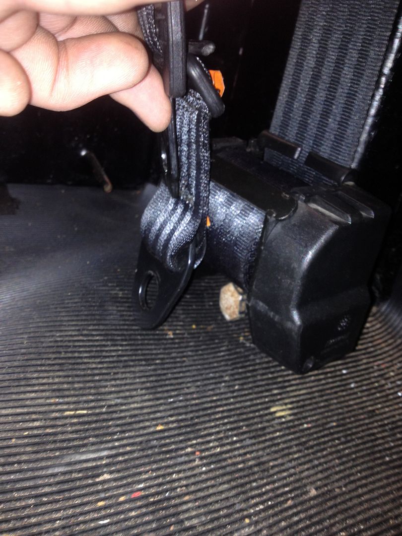

Post  Nutton on Fri Sep 11, 2015 1:42 pm
I've already bought some second hand Securon belts, they're pretty good, they hardly look as though they've been used.
The only way I can see it fitting is if I use a massively long bolt with a huge spacer to bring the belt out from the fixing.
Otherwise it'll never fit up against the reel.
'Standard' seatbelts IMG_52791_zps4y4kjzkd
I could attach it behind the reel but then the belt will be all twisted further up?

Post  Steve G on Fri Sep 11, 2015 2:58 pm
If you want to use those belts you really need some sort of extension to either lift the reel up from the floor a bit or one that allows you to fix the lap belt away from the reel. It obviously needs to be pretty heavy duty though.
What you need is the sort of belts fitted to older cars that had static belts fitted originally. Not sure if Securon still list anything but something out of a 70's Leyland car might be suitable.

Post  Steve G on Fri Sep 11, 2015 5:42 pm
Have a look round on Securons website. There are various fitting instructions on there this is one with a few ways to fix the belts.
http://www.securon.co.uk/fitting/extras/500fitting.htm
If you fit the lap strap behind the reel you need suitable spacers etc to allow the belt to swivel on the fixing bolt.
Hope this helps a bit, sometimes a nose round a breakers can give you a few ideas.
