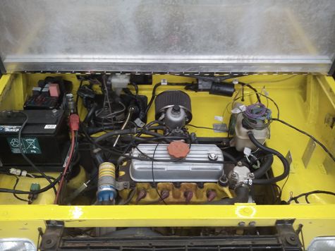

Post  Martin & Nettie on Wed Jul 01, 2015 10:56 pm
Now Dougal has a proper hinged bonnet and new led side lights
Dougal (friend of Florence) Img_2012
Wiring nearly complete and engine bay painted
Dougal (friend of Florence) Img_2013
