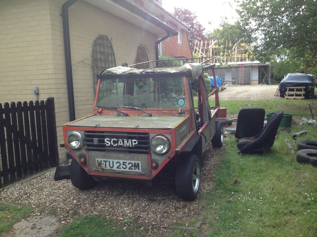

I've been after one of these for ages, so I'm chuffed to have gotten this one. With loads of parts too!
I do have a 1985 mini too but that needs some work. So the plan is to get the scamp sorted, then take the mini off the road and get that all nice again.
I picked this up at the end of last week.
The guy I bought it from said that his mate was the original builder then it went to him and it just sat on his driveway for 8 years untouched.
It all seems to be straight and true, nothing's obviously bent, I might weld some supports in to keep it that way, after seeing comments on here that the MK2s can be a bit weak.

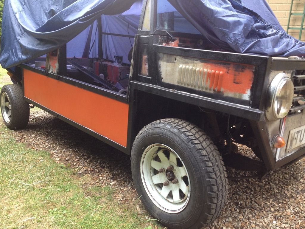

On top it's fairly sound, there's surface rust but nothing serious, it just looks a bit tatty. Underneath it's a bit more rotten but I'm hoping that I can take it back and treat it all without having to cut anything out. I'll tip it onto it's side sometime soon and have a good look.
Project.. No-Name? <a href=Project.. No-Name? IMG_4896_zpsmmypd4yi" />

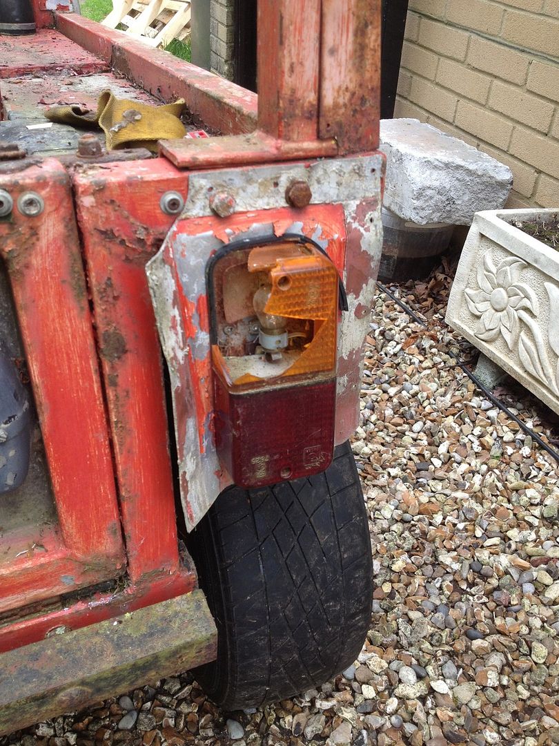

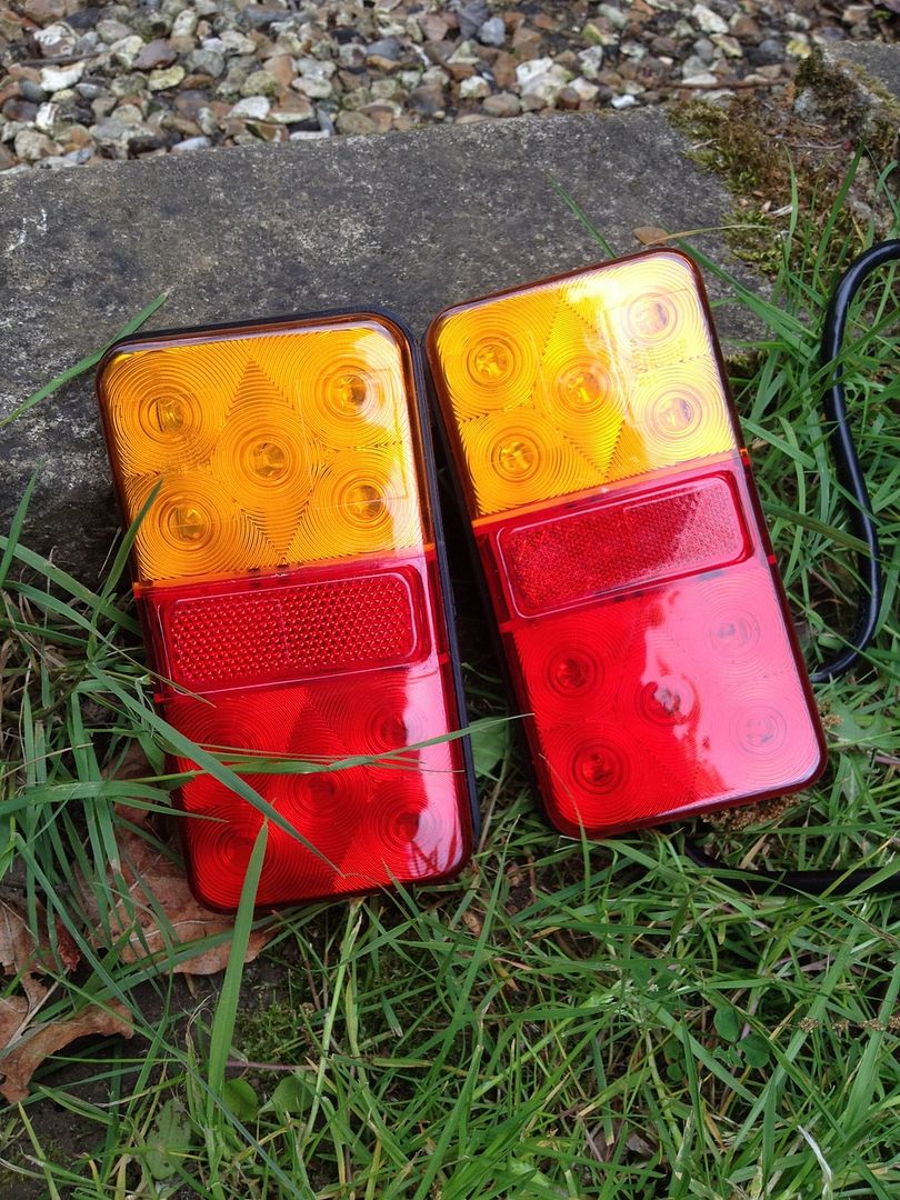

The old lights were pretty beaten up, not helped by the fact that my dad decided to back the car transporter into it. There were some new trailer lights that came with the car but I wasn't too keen on them, they were far too chunky. So I got some posh new LED lights from Amazon for £15.
Project.. No-Name? <a href=Project.. No-Name? IMG_49091_zpsizs4ezgu" />
Project.. No-Name? <a href=Project.. No-Name? IMG_49101_zpsvdsryimj" />

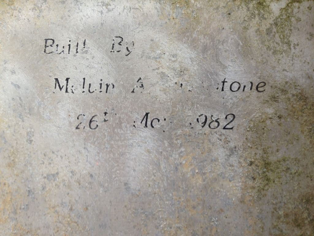

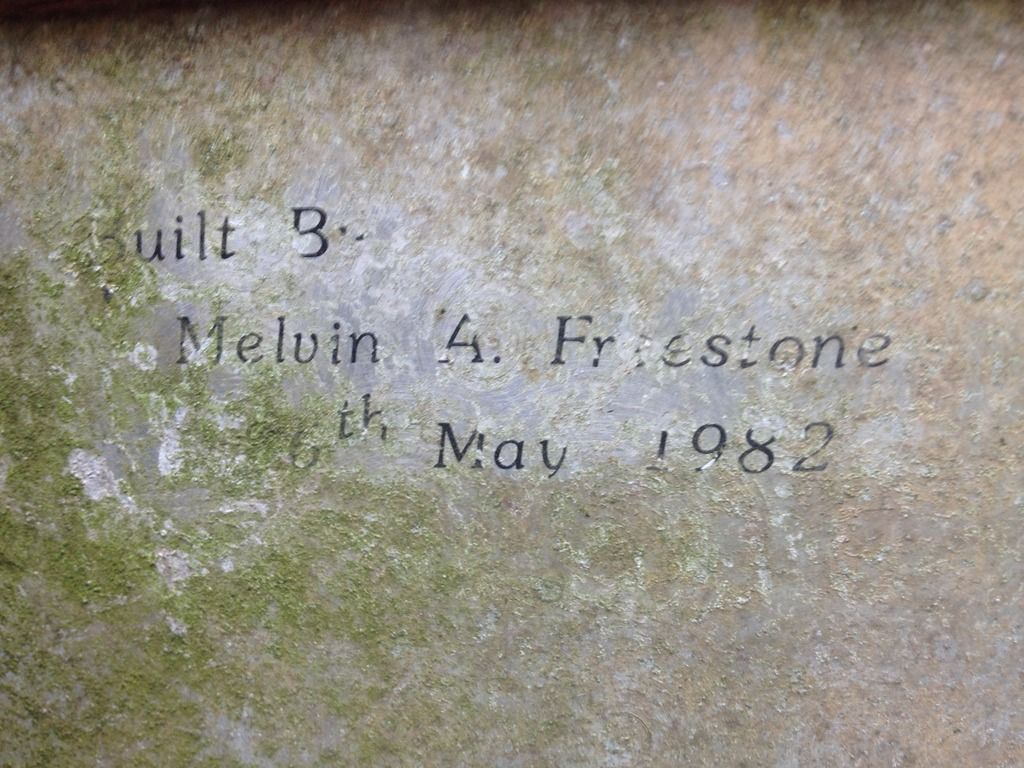

A nice little touch I've noticed on the side panels is this:
Project.. No-Name? <a href=Project.. No-Name? IMG_49041_zpsxxs3rci8" />
Project.. No-Name? <a href=Project.. No-Name? IMG_49031_zpsw50whhqk" />
"Built By
Melvin A. Freestone
26th May 1982"
If they weren't already so worn and disappearing I think I'd have made sure to keep those there. I might put it back on myself after I've finished.

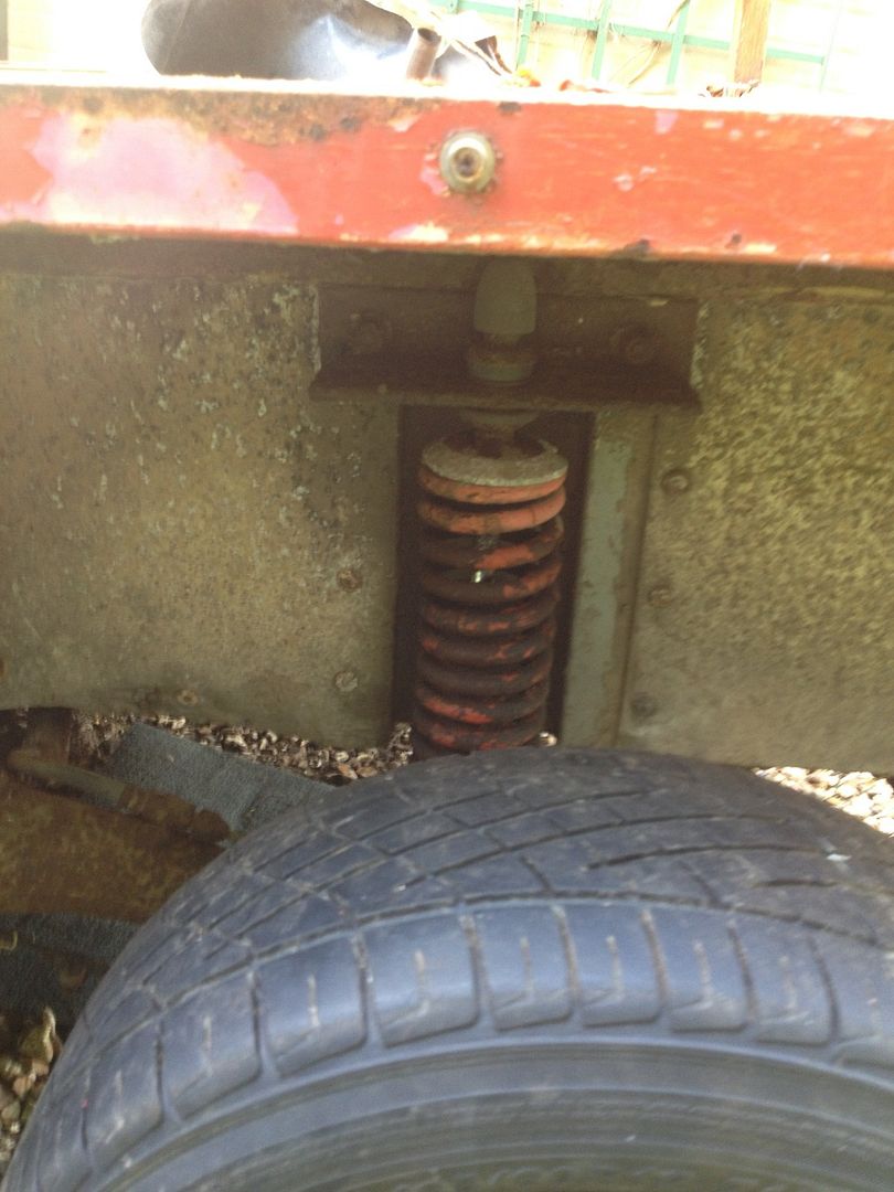

The car has coilovers fitted to the rear but the standard cones on the front. the springs are really soft and seem to jack the rear up quite a way. It still has the fittings for cones so I'm tempted to put some back on, to get it a bit stiffer and lower. I doubt I'll be using the car offroad very much and I've already pulled out a rotten rear seat because I want to use the full bed as a pickup.. but I dunno.. maybe leave the coilovers fitted and see how it goes.. I did get a couple more springs so maybe I'll embrace it and try to fit coilovers to the front too. Rolling Eyes

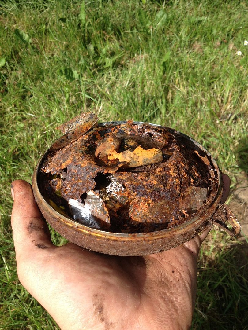

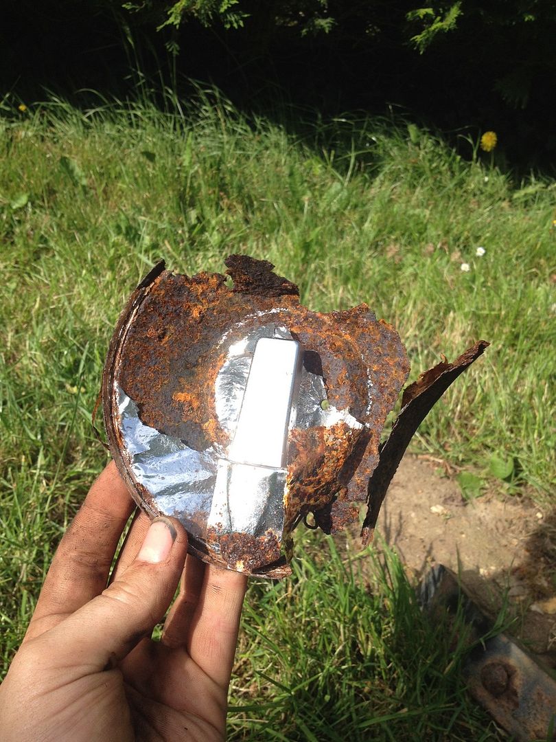

Just a note of interest: the bumper had a couple of spots fitted that looked a bit tired and one of the lenses was cracked. I took one apart to check if there was a good bulb (which turned out to be spotless) and found this:
Project.. No-Name? <a href=Project.. No-Name? IMG_49231_zpsaaufrgzt" />
Project.. No-Name? <a href=Project.. No-Name? IMG_49251_zpsuwt1d7tn" />
I assume the spot just collected the water and was left to rot from the inside. Fingers crosed that isn't a sign of some hidden horrors on the car! Shocked

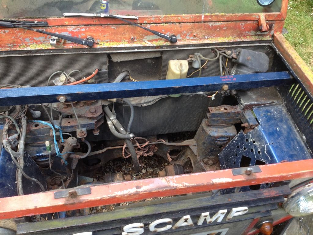

There was a bar that came separate with the car, painted in the same blue hammerite as the engine bay. It also has the plugs and points gaps written on it.
After a search I found a couple of bolts and some scratched paint which definitely seem to suggest it goes between the wings, as below. Is this common? I'm not sure if there's enough room for carbs below it.

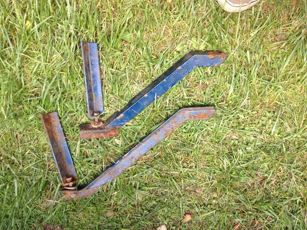

There are also these triangular pieces I've photo'd below. I can't find anywhere that they would want to fit. I assume they're for strengthening? Any ideas what they are or where they go?? One is slightly longer than the other and they're slightly different shapes.

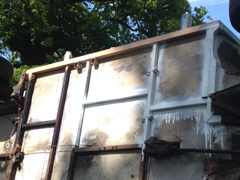

I started taking back all the surface rust on the top, starting from the rear. The metal has then been treated and painted. Tomorrow I expect I'll finish the rest of the upper surfaces and maybe tip the car over to start underneath.
[img]Project.. No-Name? <a href=Project.. No-Name? Ce034a22-258b-4070-9247-be4559e41af1_zpsntzaggeg" />[/img]
When it comes to it, I'm thinking I'll brush paint it in matte Landrover green (or similar) with black trim/details. Could I get some of your opinions? Is that too boring?
Do you have a suggestion for a better colour?

One of the places mk2 Scamps like to bend is the parts of the chassis where the subframes mount.  The cross bar, isn't a standard bit and the triangular bits probably bolt to it and then to the ends of the subframe mountings on the chassis. It looks like there is a hole in the subframe tower so they might be linked to the subframe as well.
I'm still considering coilovers for mine as it will save having all the cones and trumpets hanging under the back. Some people I have spoken to about them say they haven't been able to get them to work very well and it's more to do with the dampers than the springs themselves.
Perhaps the spare springs are stiffer ones, might be worth a try perhaps.

I seem to remember from other posts that the spreader bar between the towers is pretty standard for Mk2's.
Dont know about the extra bracing.

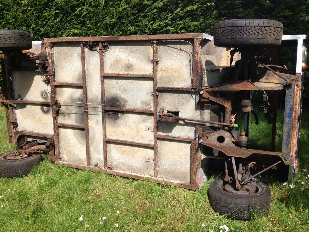

I've been working on the car in my spare time and have finished treating the upper surfaces.
I've tipped it over and have managed to finish most of the underside too.
Before I started:
Project.. No-Name? <a href=Project.. No-Name? IMG_49701_zpspavrhtoa" />
And after treating/painting some of it:
Project.. No-Name? <a href=Project.. No-Name? IMG_49731_zpsfx7ayb71" />
So far It's all been pretty good, there haven't been any hidden horrors and there's nothing that needs to be replaced. I haven't needed to take any panels off either because all of the tubing had sealant between it and the panel.
I just need to finish the last couple of rear pieces now and then I want to drop the subby out so that I can attack that properly and get at anything hidden behind it.

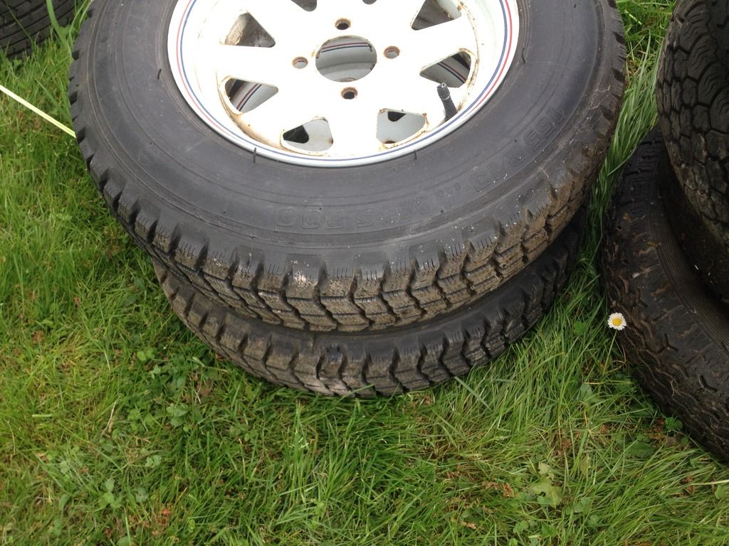

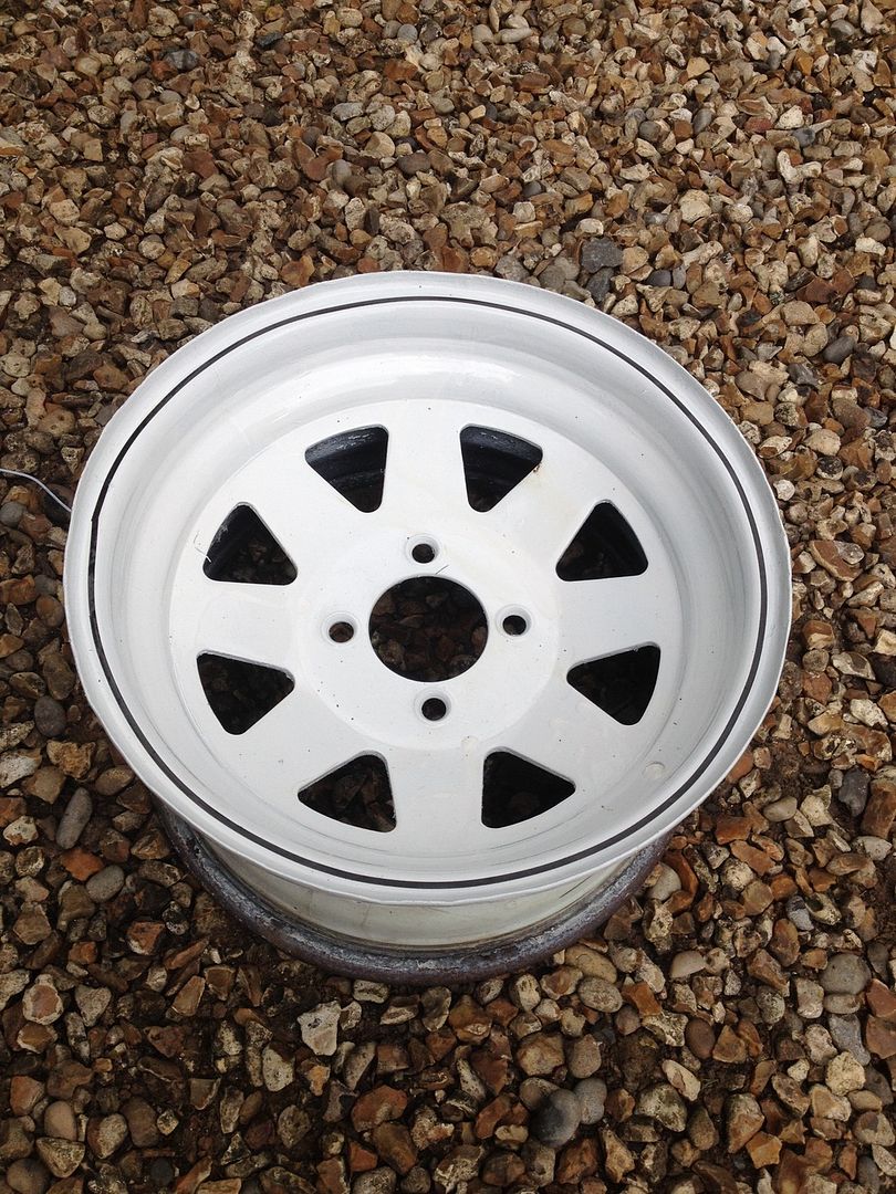

I picked up some 13x7 Wellers for this, which needed some work, so I took them back to the metal and repainted them.
I was thinking about getting some blue/red stripes and Weller stickers to put them back to how they would have been but I tried some single black stripes first.... Thoughts? Very Happy
Project.. No-Name? IMG_49741_zpsa7m6jyg3

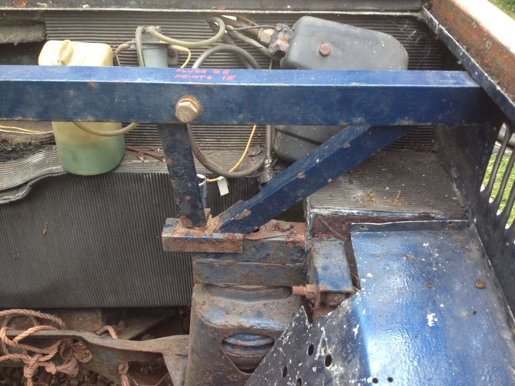

I had another play with those triangular pieces and managed to figure them out.
Do you think these will be enough for normal use? It is all thick heavy steel and I assume any load will be up/down so this should do the job... right? Smile
Project.. No-Name? IMG_49581_zps5utodha7

Glad you figured out the braces. I think anything will help in terms of strengthening the subframe mounts but the main load will be taken by the diagonal one. For road use they probably don't need anything. The mounts on my car were bent and one had been welded. I think the main problem was that the subframe broke.
One thing you might struggle with with your wheels is the clearance between the tyre and the inner wheel arch on full lock, a lot will depend on the tyres you are planing on using. Late Minis have lock stops on the racks to prevent the wheels rubbing so that might be one way to deal with things.
I have just noticed that your chassis has been modified a bit to give a bit more clearance for the front wheels. Yours has cut away sections on the front floor tubes. It's interesting to see how odd bits get changed. It might help get the bigger tyres on.

Unless you have extended radius arms, then you wont get 13" wheels/ tyres (unless they're 50 profile) on the back.

The car came with 13x5.5 Wellers with huge profile knobbly tyres already fitted so I think it's all already been done.
The rear wheels do sit a long way back, the box section that would have been behind the rear lights has all been cut away, otherwise the wheels would have fouled on them.
There's plenty of room for them at the back.
I had noticed the alteration at the front but hadn't really thought too much about it. Now it makes sense!
As these wheels are wider than the others, I wonder if that'll be enough.. I'd prefer to avoid an MPi rack if I can, so I might modify that front part a little more if I find I need to.

These are the wheels and tyres it had fitted:
Project.. No-Name? IMG_49061_zpsntntfo95

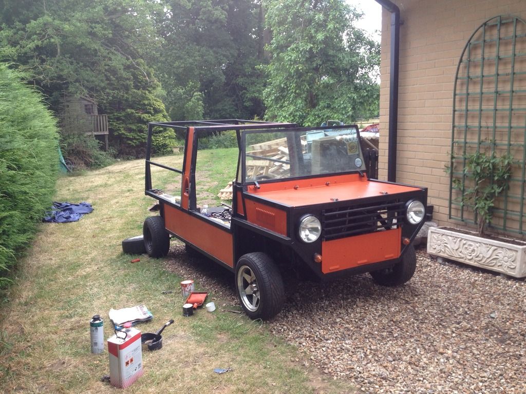

So the frame has all been treated and painted now. I did need to do a little patch work but nothing I couldn't handle.
The whole frame underside has been coated in anti-stone chip just to give it a bit more protection and I've put flexible watertight sealant between all the frame and the panels.
I've even managed to get a little bit of the top side painted! Very Happy
Project.. No-Name? IMG_50121_zpszemwji1s
I had another quick look at the wheels. It looks like the alterations have all been tailored for those 13x5.5s with the huge kingpin tyres.
There's plenty of room there for the 13x7s with normal road tyres, but if I wanted to fit big knobbly tyres, I'd need to alter the back part of the front arches a little more.
I'm planning to use road tyres anyway though so that wouldn't be a problem.
Maybe I'll get some more kingpin tyres for the thinner wheels anyway though. Then if I'm going to use it off-road, I can just change the wheels.
Do any of you have experience with the Kingpin remoulds? Are modern remoulds getting better or are they still a bit of a risk?
Thanks

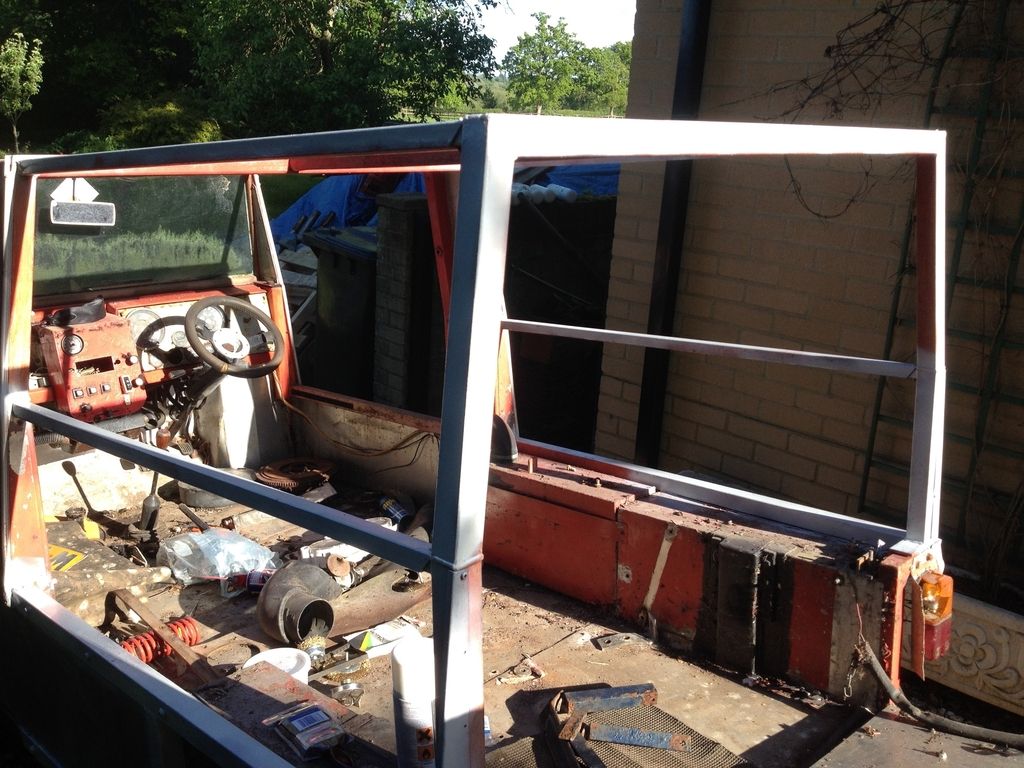

Post  Nutton on Fri Jun 26, 2015 9:31 pm
It's getting there!
Project.. No-Name? IMG_50611_zpswlyyasrn

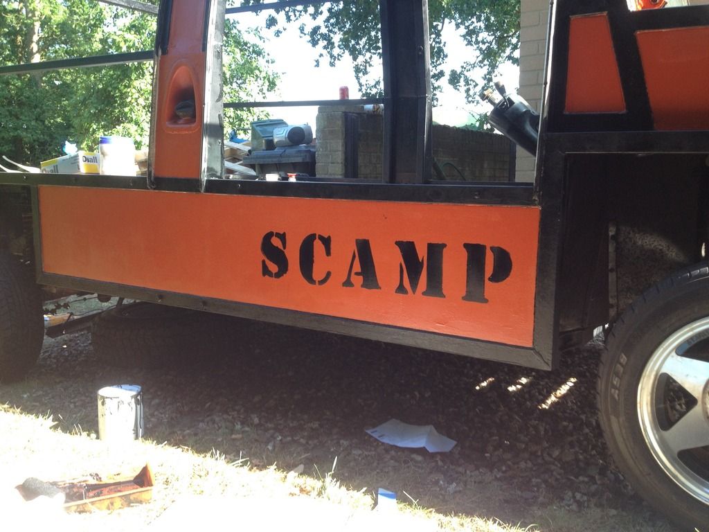

I did manage to do some stuff today though, mainly on the tailgate and this:
Project.. No-Name? IMG_50961_zpslnwatiwh

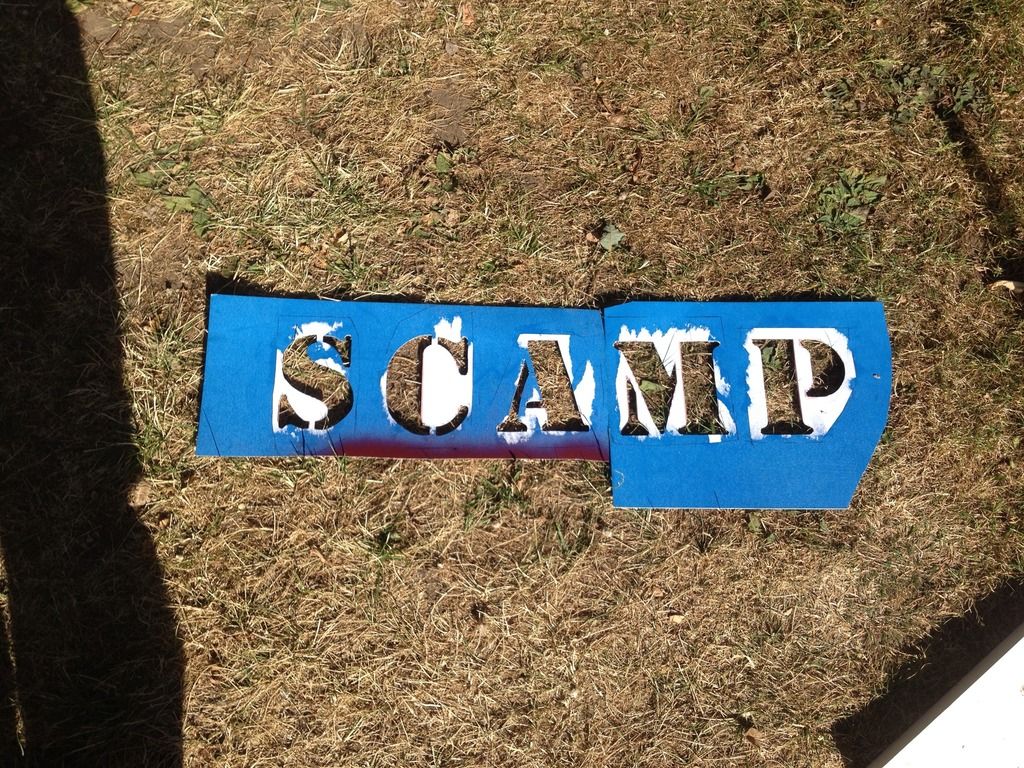

I made myself a template using military style font
