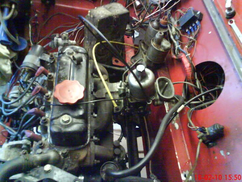

The bottom of the carb where the float bowl is looks a bit more bulky, I dare say someone has done it though. I measured up to see if the MG Metro Hif44 would fit on mine but it looked a bit tight against the bulkhead so I have modded it a bit to suit. Hopefully it will fit and I haven't measured it wrong !
What size engine do you have in your Scamp, if you are swapping bit's from a 1275 to another then you should be Ok, if not you will probably need a different needle in the carb at the very least, not sure about the head fitting either there could be the problem of the bypass hose to the water pump.
On the other hand what bits do you need ? Someone might have an old carb lying about, what about Burlen Fuel Systems for the parts ?
Metro carb in Scamp. Empty Re: Metro carb in Scamp.
Post  Steve G on Mon Apr 06, 2015 11:09 pm
Just found this picture which might help.
Metro carb in Scamp. DSC01379_zpsuu41dnxu
I created more of a clearance problem with mine as I have altered the subframe mounts but as said it just looks like a non standard air filter might be a bit tight.

Just seen the pic thank you. Hard to tell how much room you've got but if it's do-able at least I have a fighting chance. I'll make up a filter box if necessary so not worried about that.
