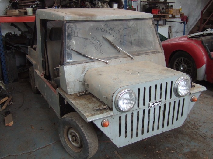

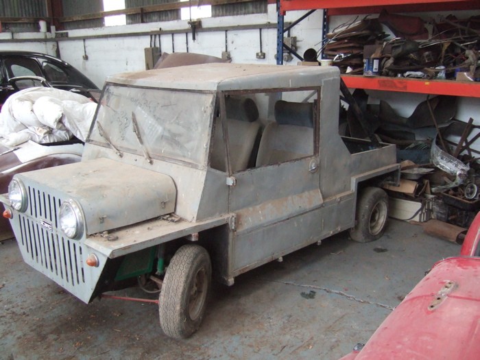

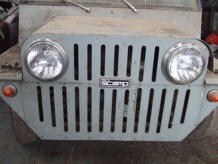

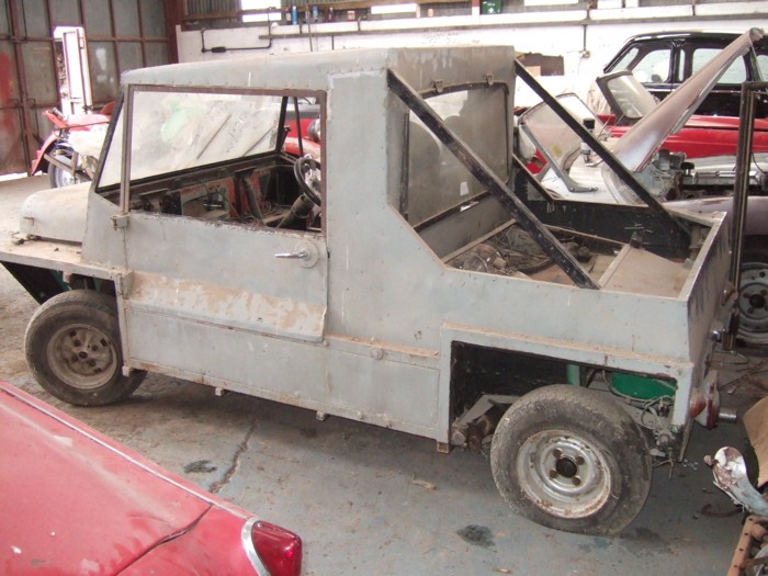

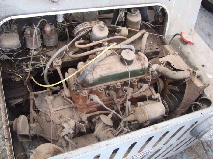

Hi fellow scampers.
I thought i would start up some kind of build log and hopefully a place to discuss my progress and ideas.
Hold on  for more up to date pics, i need to host them somewhere first. Ill start with the brightwells auction pics first
Mk1 scamp pickup. Likely to be moke inspired S1_5
Mk1 scamp pickup. Likely to be moke inspired S2_5
Mk1 scamp pickup. Likely to be moke inspired S3_5
Mk1 scamp pickup. Likely to be moke inspired S4_5
Mk1 scamp pickup. Likely to be moke inspired S5_4
Mk1 scamp pickup. Likely to be moke inspired S6_4
The reasons i bought this one are that it was silly cheap, it has a cool looking/styled hardtop (i love the rake it has and the general shape of the roof) and the Jimini style front end. Apart from that i see lots and lots of stuff i plan on changing Very Happy
There are many things that need attention. The whole frame needs to be shot blasted and re painted. The engine has no core plugs and i doubt its ran properly since 1988 (last tax) we kinda got it running but lost interest :/
The car looks like it was built well, originally, but it looks like a pleb has been let loose on it with a welder and an angle grinder. The roof structure was terrible and very dangerous.
I cannot wait to get the frame all done ready for a new roof structure and some modifications to bring it more up to date. That feels like a million miles off at the mo. I have a swift engined mini that i will be taking apart as a donor. I will not be using a swift gti engine in my moke though. Im not even sure ill be able to fund a decent a-series so i may take the cheap and easy option of using a cg13de out of a k11 micra (they are 1275cc 16v 85hp and have a 5speed box attached) my mk1 micra has one of those engines and i get 45-50mpg flatout haha
