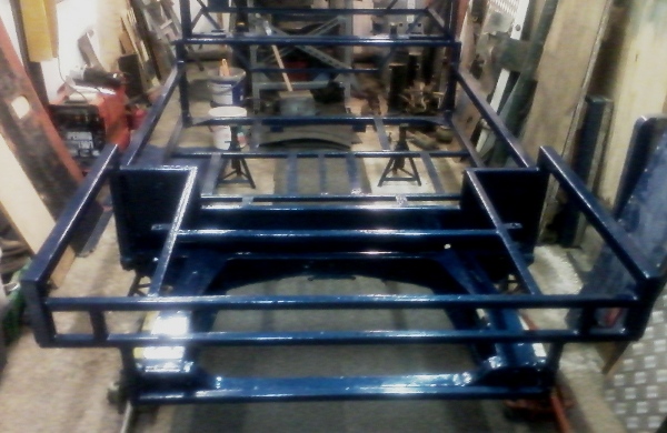

Florence gets painted! Img_2024
Nettie said after the Picnic she can't be secretary without her Scamp Florence, so two trips to the tip to get rid of accumulated this and that to get at Florence and gave her chassis a nice coat of dark blue this afternoon (thats the easy bit).
