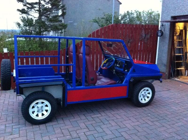

Mines is fitted with the extended swinging arms, with standard cones on the back and it's still quite hard:
