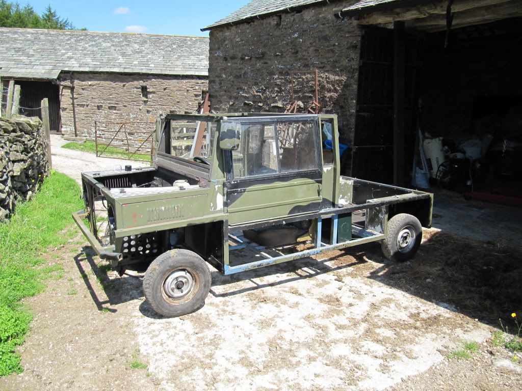

Well not sure where to start but I have just bought this !

This is how it arrived after a very wet trip home.
I have the original subframe that shows signs of being welded up and another thats in a bit better condition and thats about it.

Post  Steve G on Mon Mar 17, 2014 2:11 pm
This is it after a big clean up. Lots of moss and dirt were inside it that went and I removed a lot of the original fittings as they were beyond using again. I fitted the better of the two subframes and removed the welded on roll cage legs it had as well.

Post  Steve G on Mon Mar 17, 2014 2:29 pm
If only thats all it needs ! It isn't quite as bad as I feared but is still going to need a fair amount of work done to it.
