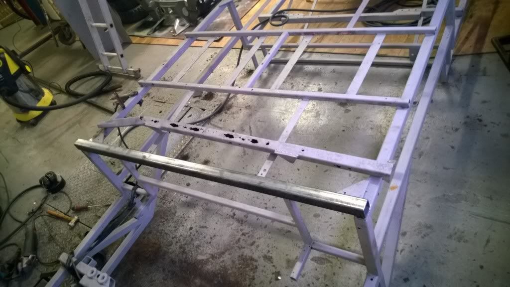

twin engined mk1 Empty pictures
Post  dylan on Tue Feb 25, 2014 4:15 pm
Here are some pictures.
One engine is finished, Chassis and subframes sandblasted, welding started, body panels orderd,elektronics for the carburaters is in progress.

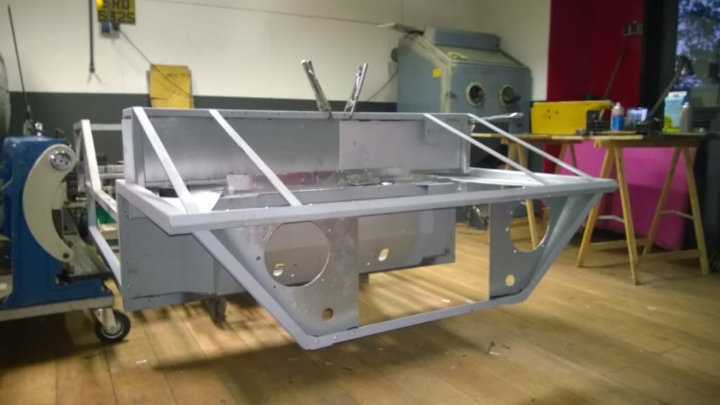

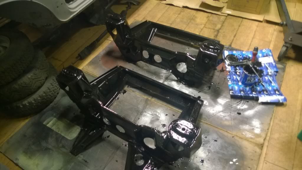

Post  dylan on Tue Apr 29, 2014 12:03 pm
Here are some pictures, to show the progress.
twin engined mk1 WP_20140422_001_zps2448586e
twin engined mk1 WP_20140325_003_zps4f8d9bdd
Made new body panels because the old ones were rusted.
Now poprivet all the parts together  Very Happy
Subframes and all suspension parts cleaned and painted.

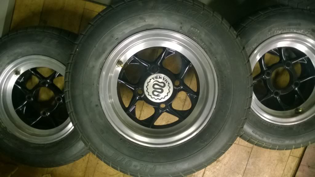

scored some nice wheels  Smile
twin engined mk1 WP_20140219_008_zpsbeca63b8

twin engined mk1 Empty Re: twin engined mk1
Post  Steve G on Tue Apr 29, 2014 1:08 pm
Post  dylan on Tue Apr 29, 2014 1:24 pm
I have used Metric tube, this resulted in some larger repairs because the original tube's doesn't match the new tube's.
All the bottem tube's has been replaced.

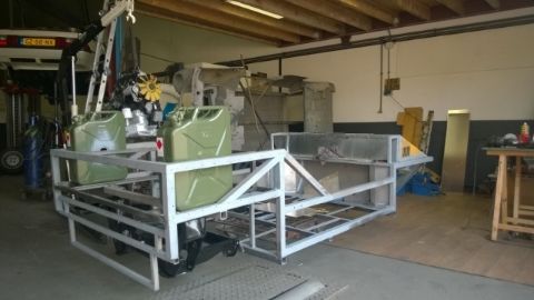

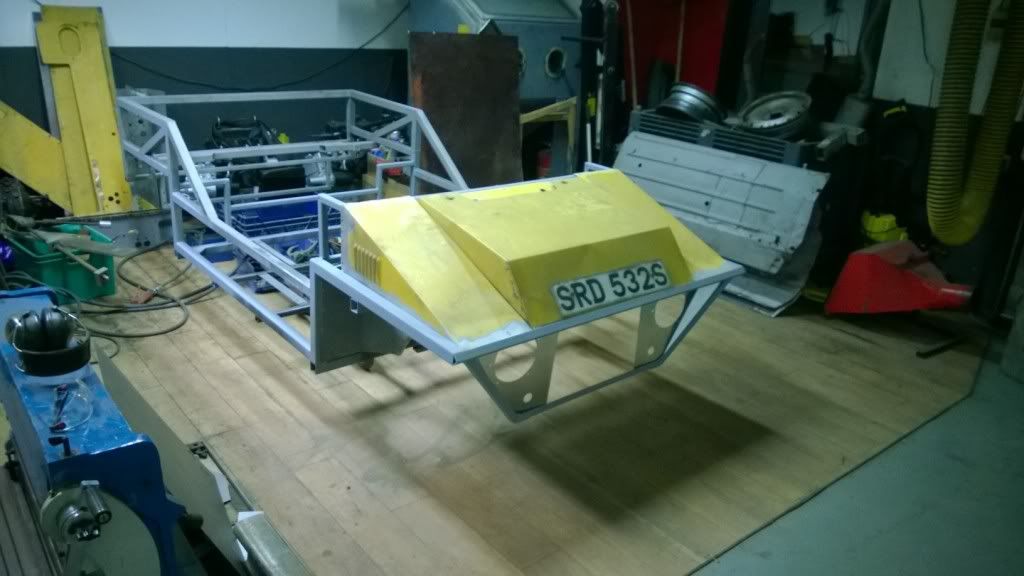

Post  dylan on Tue May 06, 2014 4:30 pm
Here's a picture of what i have in mind for the petroltanks.
twin engined mk1 WP_20140505_003_zps797a5384
The front end has all the bodywork in place!
twin engined mk1 WP_20140505_005_zpsa61accf3
Post  Steve G on Tue May 06, 2014 5:13 pm
Post  dylan on Tue May 06, 2014 5:26 pm
that's something i didn't think off.
I am using a electric fuel pump, i will make up a test stand just to be sure.
dylan
dylan
Number of posts : 15
Location : Veenendaal, Holland
Job/hobbies : strange mini's
Registration date : 2011-08-25
View user profile http://www.autobedrijfmaasdoek.nl
Post  Mk3rob on Tue May 06, 2014 5:34 pm
Temperature expansion might push it through as well.
We are here to be helpful, honest Twisted Evil
Post  dylan on Tue May 06, 2014 5:54 pm
there will be some vents in the top off the cans, so temperature expansion shall be no issue..i hope.. Sad
