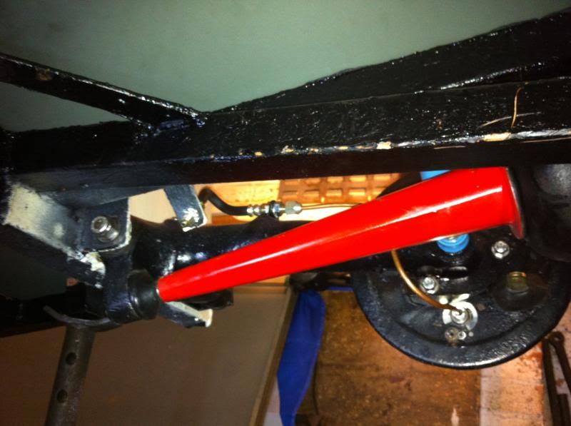

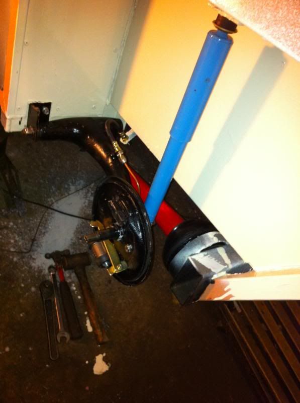

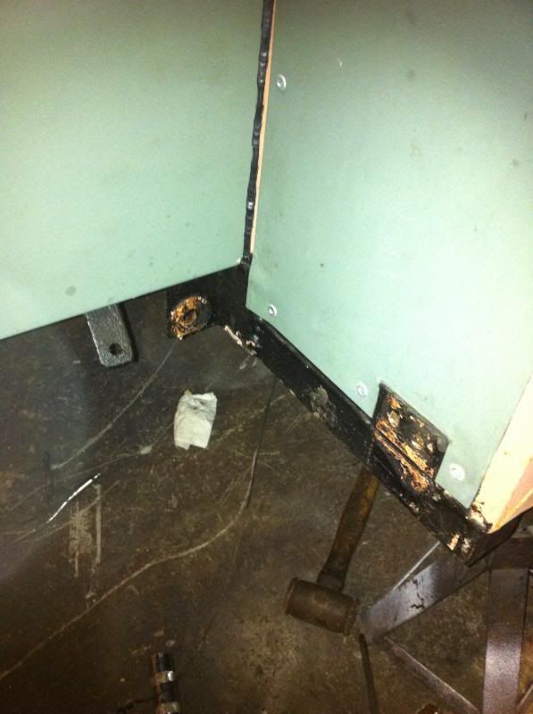

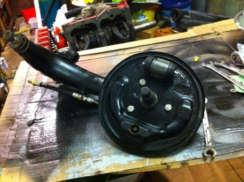

Post  Minivanman on Mon Dec 09, 2013 8:41 pm
Had some time off work recently, so spent some time in the garage with my rebuild:
Scottish Scamp 020_zps23166ff1
Scottish Scamp 026_zps16166860
Scottish Scamp 027_zpse455e47d
Scottish Scamp 016_zpsedda4fba
Scottish Scamp 014_zps4973e2a5
Scottish Scamp 023_zpsf296e5a2
More to come in the future

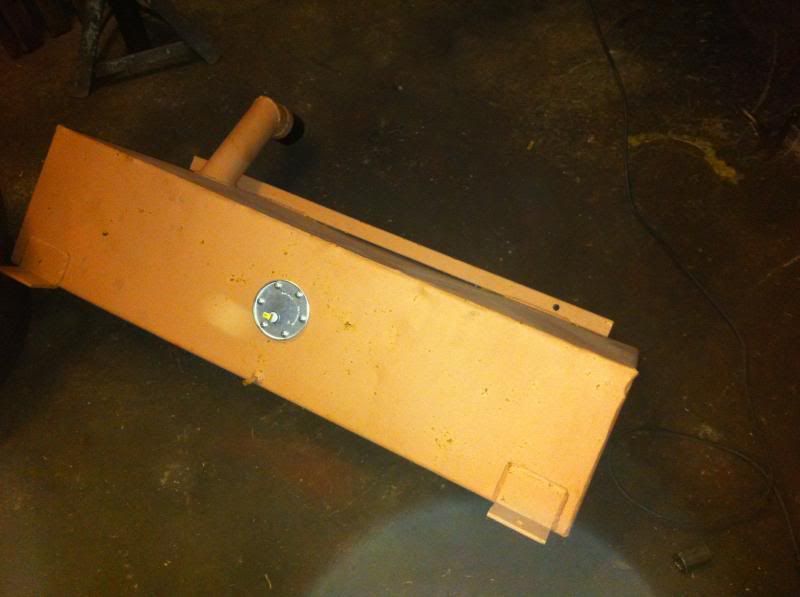

Post  Minivanman on Thu Dec 12, 2013 5:45 pm

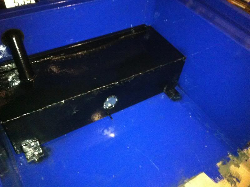

New petrol tank now in place:
Scottish Scamp Tank005_zps913659cc

Post  NG Guy on Fri Dec 13, 2013 11:09 am
Hi Davy,
Not sure why, but didn't see the yellow petrol tank before. Is this an Andy Mac item or one you have made/purchased elsewhere?
Anyway very glad you are pressing-on with your build/rebuild; hopefully see you and your Mk3 at some meetings next year!

Post  Minivanman on Sat Dec 14, 2013 12:33 pm
NG Guy,
Yes I seem to have lost the link to the original photos, and put these ones up to fill the gap.

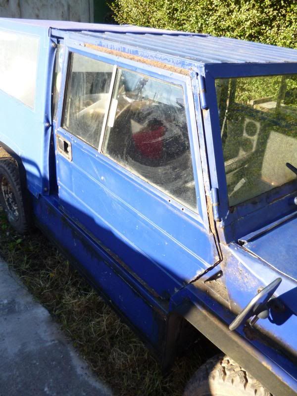

Post  Minivanman on Sun Jan 12, 2014 5:58 pm
Been having problems locating some special bits for my project, doors, roof, canopy etc, came by this old tired MK3, so purchased it and making an updated version using both vehicles:
Scottish Scamp <a href=Scottish Scamp Scampdoorsandsoftop002_zps9d6595ef" />
The project continues "Boom Boom"  Very Happy Very Happy

Post  Minivanman on Sat Mar 08, 2014 8:33 pm
Decided to fit extended swinging arms on the rear to allow the fitment of M&S tyres, I'm led to believe that the shockers are longer than the normal mini rears, what shockers should I use, sombody mentioned Chevette, not sure if that means front or rear, anyone help
Davy
Minivanman
Number of posts : 84
Location : Kilmarnock
Job/hobbies : Planning Engineer
Registration date : 2013-07-14
Scottish Scamp Empty Re: Scottish Scamp
Post  TRR Motorsport on Sat Mar 08, 2014 9:44 pm
We used Van shocks on our MK3 but what you need to watch is the change to the spring rate caused by extending the radius arm. It softens the rear suspension and buggers up the handling.  Fitting red spot comes to the rear should sort it though ;-)
Post  Mk3rob on Sun Mar 09, 2014 3:12 pm
My Mk3 Scamp is the oddity in the Club.............. Its got Moke longer swinging arms and takes 13" M&S no probs. Very Happy
I was advised about Chevette shockers but the vary year to year front to back and I got the wrong ones which were to long and bottomed out. they're still in my garage somewhere Mad
Where were we ..... I have standard length non adjustable Spax on mine along with Hi-Lo cones. Adjusted right they still give a bit of shocker movement and the 13" wheels fill the wheel bay nicely.
I always think that 10" 0r 12" on the back look wrong.
12" on the front and 13" on the back gets the rear end up enough not to be continually scrapping the exhaust all of the time.
