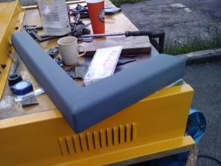

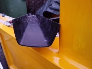

With regard to wheel arches, if you want semi solid ones...
Get some "U" channel guttering from b&q. About 5 for 1.5m length.
Cut one leg off with a sharp stanley knife.
Measure the vertical height first, & then mark a 'V' on the outer leg for the mitred cut. Dont mark it at 90, mark it so the V is less than 90 & cut the V out. Also leave about 3-6mm of flat at the bottom of the V.
Use a hot air gun & gently heat the guttering along the flat face, then bend around a square strip of wood & hold in place till its cooled down.
By cutting the V less than 90 you should now have excess material to trim off the joint & make a neat join. Dont trim yet.
Temp clamp arch in place.
Either drill & tap mounting holes, or drill & use tech screws to bolt in place.
Now trim the joint.
Use some solvent based gutter glue (b&q - its made by marley) to glue the joint in place.
For best results, roughly score the back of the joint & epoxy or fibreglass in place.
If you going to paint the arches, dont forget to flat them off with p120 grit sandpaper & spray them with plastic primer before putting the finished colour on.
Job done.
Ps folding the joint takes a bit of practice, so try out on some waste first.

I did the arches on Pea like that after she was retired from off-road duties. They do make good looking wheel arches. Very Happy
