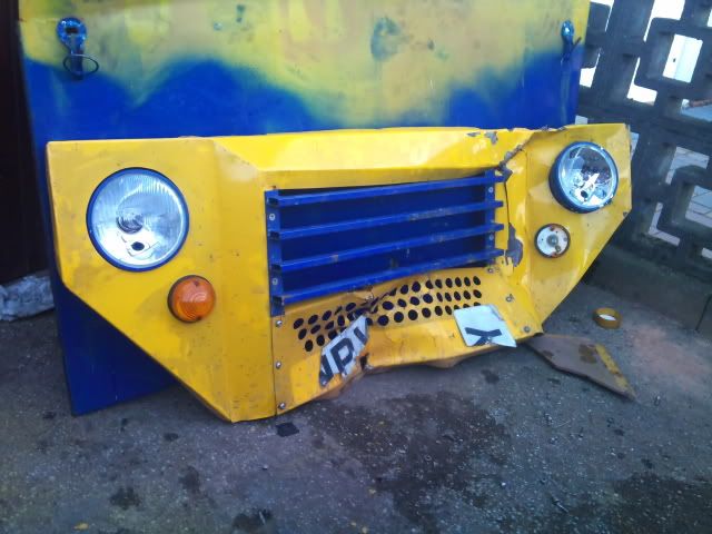

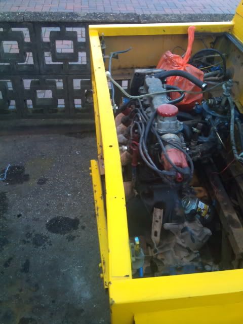

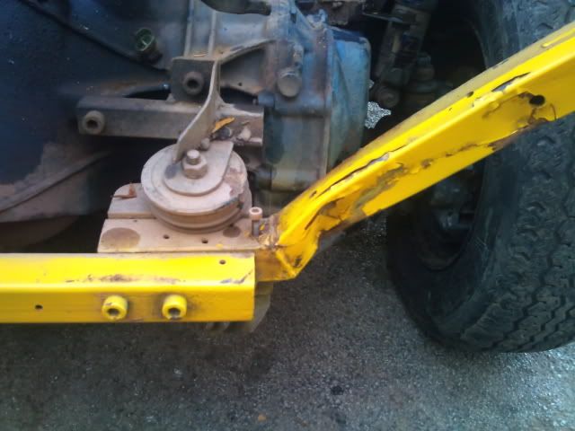

Rebuild has started....woohoo
Done some quick alignment checks & taken some measurements........oh shite...
Distributor - smashed low tension plug socket off - scrap.
Radiator - bent, mangled & holed - scrap.
Fan - casing in 8 pieces, 2 blades split - scrap.
Headlights - both smashed - scrap.
Indicators- 1smashed, 1cracked - scrap.
Number plate- 14 seperate pieces spread across redditch - scrap.
Front grille- bent & buckled - scrap.
Front panel - totally buckled - scrap.
Bonnet - buckled & twisted - scrap.
Bonnet pins - bent - scrap.
Subframe- twisted - scrap.
Engine mounts - bent & cracked - scrap.
Front wing panels- buckled - scrap.
Pedal box - buckled, twisted & cracked welds - scrap.
Front chassis - from windscreen forwards every tube is either bent, buckled or twisted - scrap.
Bulkhead - buckled from engine smashing into it - scrap.
Inner wing panels - smashed or buckled - scrap.
Horn still works tho' !!!!

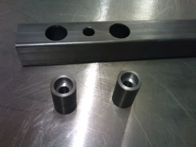

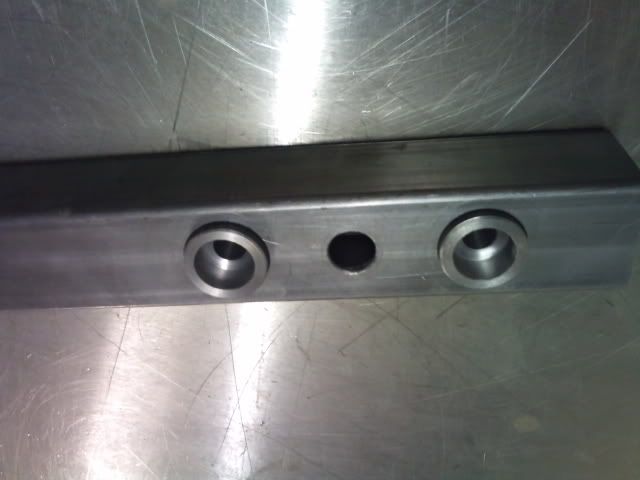

Heres the new turret mount, fresh from the factory last night (machined the holes in on the miller & turned the inserts on the works lathe).
[img]Neil's Incident - Page 2 2012-01-21233222[/img] & [img]Neil's Incident - Page 2 2012-01-21233419[/img]
Shiny tower mount was then bolted in place & the inserts welded. Front to rear braces were made earlier in the week & were clamped in place, then welded to tower mount & dashboard rail.

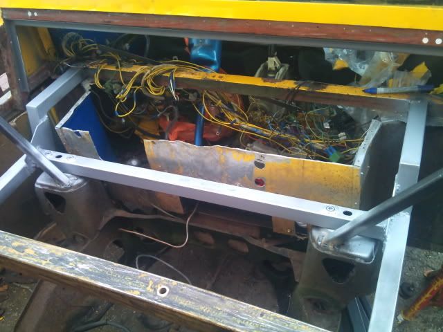

Angled braces & spacer tubes have now been welded in as well as starting to plate in the tube joints. (Got loads of 3,4 & 5mm plate ready for uber gusseting !)
[img]Neil's Incident - Page 2 2012-01-22163137[/img]
Now the subframe is solidly mounted at the rear end, i've cut the bent front hoop off for improved access. The front of the subframe doesn't show any wobble, but i've added temporary tubes to support it from the floor.

Post  SUMB on Sun Jan 22, 2012 8:08 pm
Think you might regret welding the diagnal brace to the sub-frame top, only really needs welding to the top subframe mounting cross member - especially as you might want to seam weld the tower top for strength Very Happy
But looking really good mate
Number of posts : 531
Neil's Incident - Page 2 Empty Re: Neil's Incident
Post  nhazelwood on Sun Jan 22, 2012 10:31 pm
Chaz,
The diagonal brace from the top of the subframe turret is only temporary
I've bolted the subframe using the rear lower mounting holes, then temp welded the complete subframe to the chassis to lock it in the right position. Once i've welded the new sections of chassis in, the temp braces will be cut off, allowing the subframe to be unbolted.
Have to agree chaz, i'll definately be seam welding the subframe. The old subframe has split several times around the turrets. May even consider wrapping and seam welding strips of 3mm plate around the parts i've already had crack / split.
Post  TRR Motorsport on Mon Jan 23, 2012 11:29 am
Have you thought about a finish for the subframes?
I after i had seam welded and braced the subframes for my Mini i had them powdercoated satin black. They look stunning.
I'm now a powdercoat convert Very Happy
