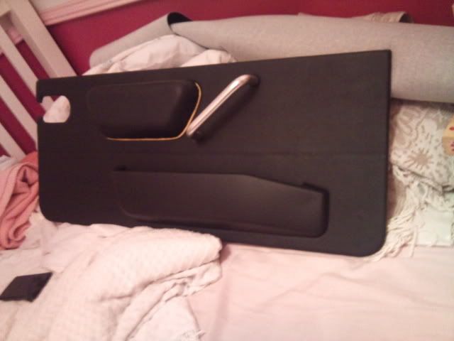

Passenger side door card is now fully trimmed & ready to go on...
Neil's Incident - Page 6 2012-11-11213809

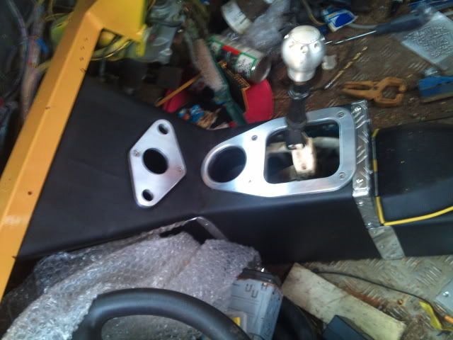

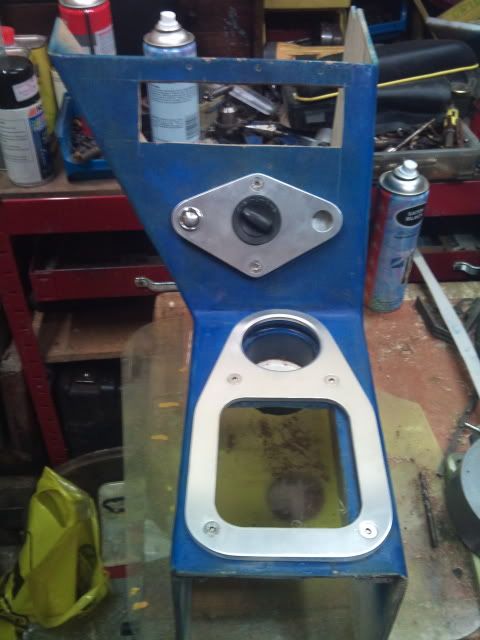

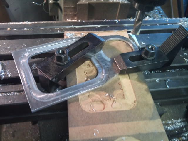

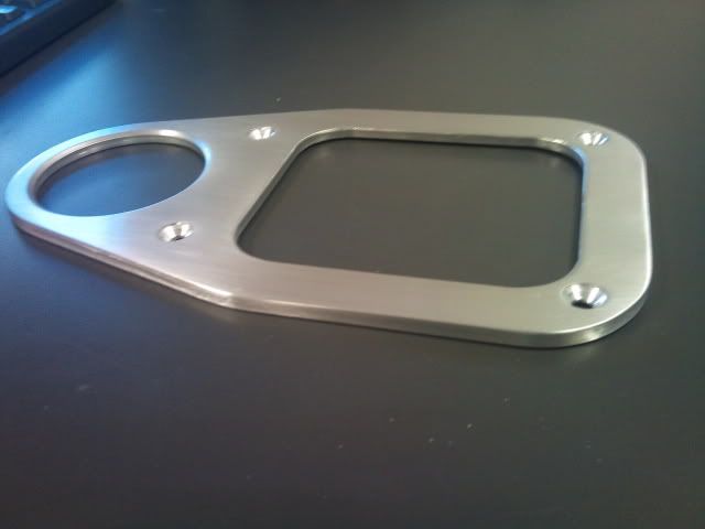

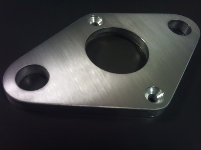

I know that "CNC Machined, Billet Aluminium...etc..." is the prefered way for "Performance" parts, so i've gone old school Rolling Eyes . Wound all the handles & pulled all the knobs myself in an attempt at the "Handcrafted" look. Rolling Eyes
Bit of sandpaper & scotchbrite later... Cool
Neil's Incident - Page 6 2012-11-10152249Neil's Incident - Page 6 2012-11-09195204-1
Walle's got some Bling at last.... Shocked
Neil's Incident - Page 6 2012-11-10165315

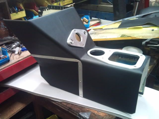

Quick pic of the centre console... Cool

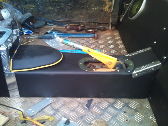

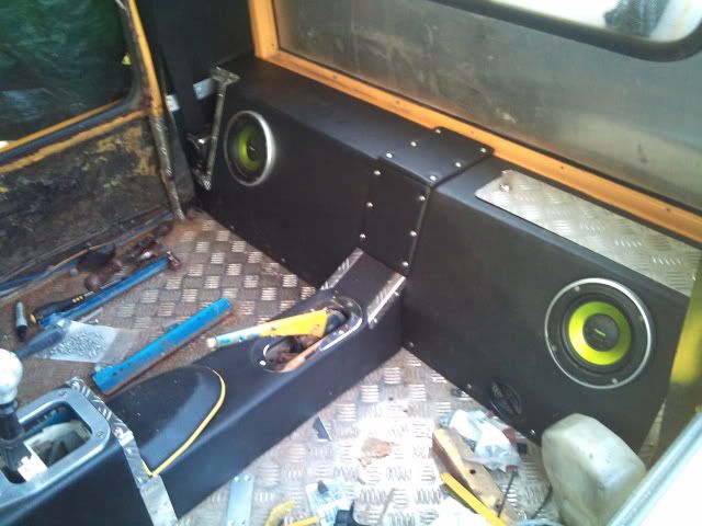

Couple of photo's, with one for Rob to prove bodging quota is being achieved...
Neil's Incident - Page 6 2013-03-31185459_zps63ec38fa
Neil's Incident - Page 6 2013-03-31185444_zpsc6df4060
The yellow trimmed bit in front of the handbrake is hinged to allow access to the brake bias valve underneath.
Neil's Incident - Page 6 2013-03-31185429_zps35b96ceb

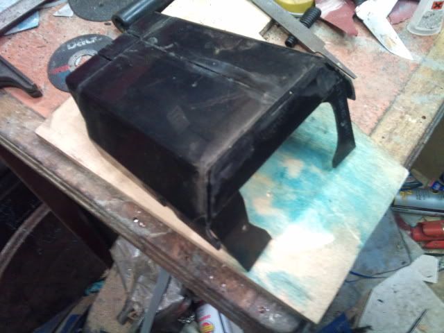

Top half of the steering column cover:~
Neil's Incident - Page 6 2013-03-31185547_zps3f97b6f8
Had the thought "Why should expensive sports cars corner the market on composites & exotic materials ?"
So after some superglue fumes I've started to use some "high impact, long chain polymer, thermoplastic based pre-stressed sections, utilised from the cutting edge technologies in use by effluent disposal & maintenance systems".
Yep, the steering column covers are being made from guttering & drainage pipe.... Rolling Eyes

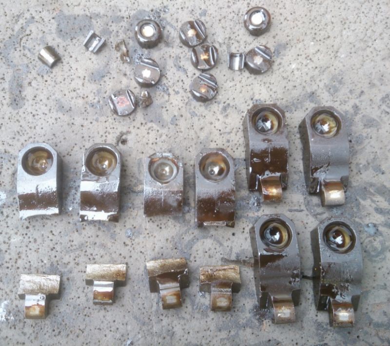

Right....finally got the funds & time to sort out Walle's water pump & timing belt issue's.....
Remove the remaining covers & paint....
Remove & fit new water pump...
Align crank, ready for timing belt....
Align camshaft, ready for timing belt....hmmm....that's gone tight....
Remove rocker cover......B@ll@cks....
Remove camshaft housing......Double B@ll@cks...
Remove cylinder head.....Triple B@ll@cks...
Neil's Incident - Page 6 2777dd50-1561-415a-a7eb-99dfc2983024_zps57ed22cc
Neil's Incident - Page 6 05e2b1d7-5b17-4c2f-872d-981a54a97292_zps92502aa3
Neil's Incident - Page 6 67b554af-67ce-463f-a9e1-8e7c598df39b_zps23675651
Bugger, just wasted £60 on belt & water pump....now i need a new engine.....sigh
Live has a habit of kicking me in the happy sack's.....

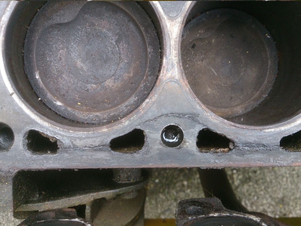

When i put the engine back in after the crash, it seemed fine, but made the odd knocking noise... whistle
At Stourport got 1/2 way to the trig point when the knocking suddenly stopped...like the engine...
The pulley had come off the water pump, which consequently threw the timing belt off.....
This caused at least 4 of the valves to hit the pistons & self-destruct the rockers & followers.... Evil or Very Mad
The cracks in the block don't look new....which is a bit troubling..... scratchchin
