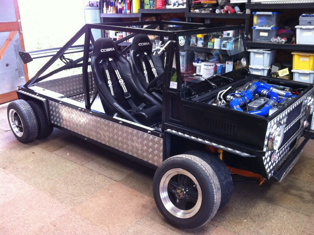

recently found the forum and wanted to show you my Scamp, I think its a Mk2 , I wanted to go for a racey look so made up a roll cage , then to match the looks me and my dad fitted a metro turbo engine so she goes much faster than she looks

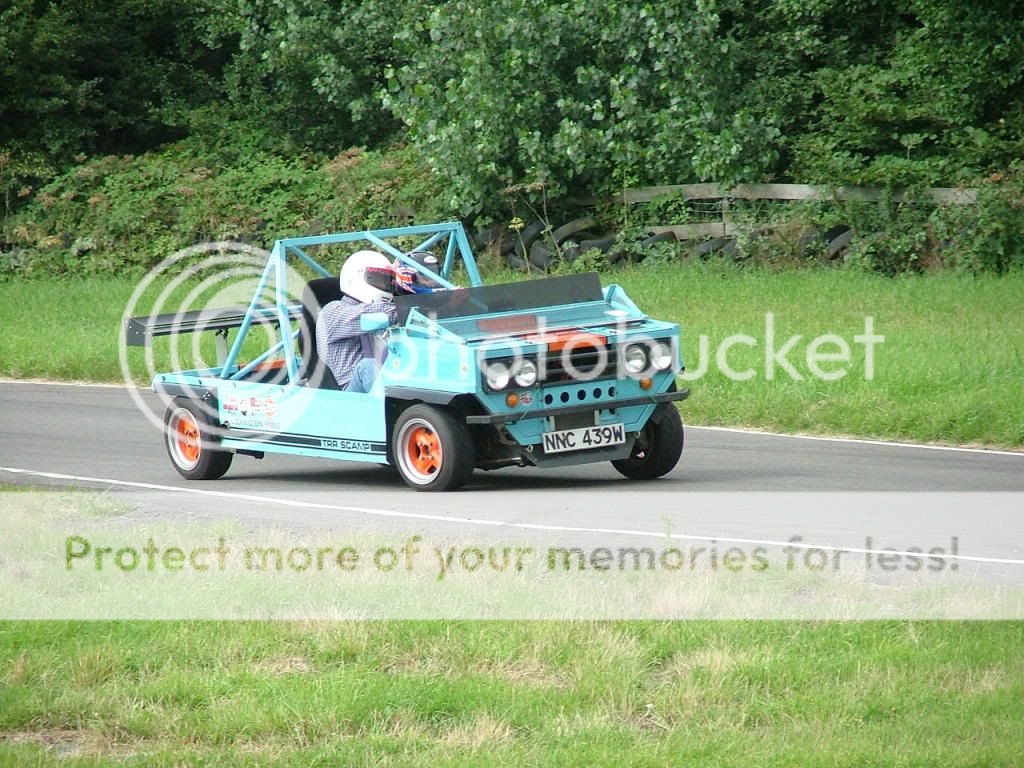

Nice to see a Scamp on a circuit again - I bet the insurance is high (probably on his dads) suggestion lose the windscreen and see the lap times drop
A racing Mk1 from several years ago.

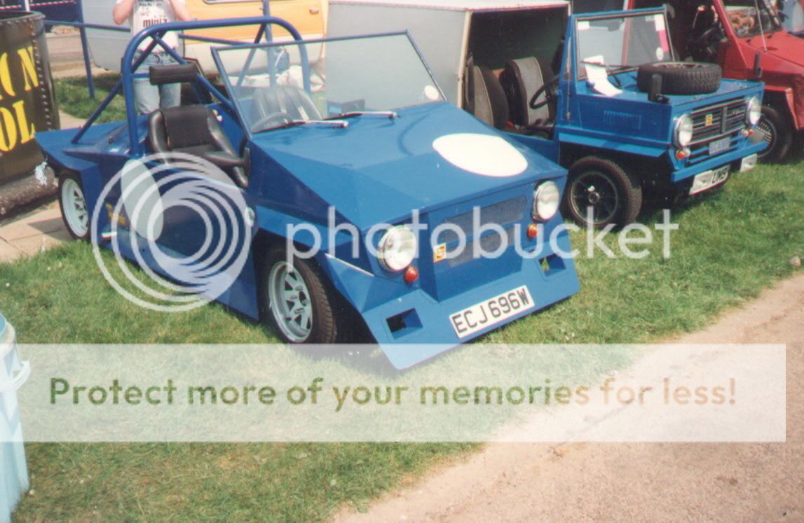

I thought i had seen it somewhere.........Castle Coombe last year
[img][/img]
[img][/img]
Re: Turbo Scamp
Was it going around the outside of a Stratos?Mk3rob wrote:I thought i had seen it somewhere.........Castle Coombe last year
Only old members will get that joke!

Having not posted since March when I stuck the Turbo engine in the sacmp I unfortunatly got carried away and managed to shear my crank ! , the good thing is about a week before this happened I got a read out of 99 BHP on a rolling road at 7.5PSI .
Going to get a new stronger engine capable of 120 + BHP in the next few months !
P.S looking forward to doing some shows again this year :-)

[quote]A racing Mk1 from several years ago.
That Racing Mk1 was a Mk2 and it was owned by Martin Bates,I have the transformation pictures from Mk2 to the racer. That's the Scamp that really p---ed off the Westfields and Caterhams at Stoneleigh one year by winning the slalom contest.He went on to buying his friend's (can't remember his name) Mk1 racer and entering it into a Kit Car racing formula(he got his name into Motor Sport Magazine - I have the clip).The chequer plated MK2 I have seen at L2B I think,it's very tidy.

Managed to get a new Benross turbo engine, if anyone know about these you will understand what they can do !, it is 1293 with omega pistons, bored out combustion chambers and over size valves mean it can run higher boost, it also has a tidy piper cam and reprofiled crank balanced to 14,000 rpm, a clubman gt box with straight cut drop gears. I have not gone for an ECU so I am not able to run mega high boost but should be fine with 10-12 Psi . One of these engines with the ECU and 16psi ran at 185 BHP in a RR session , obviously I cant say if this figure was accurate but I will be happy with anything over the 100BHP !
Should have the engine in and running for Riv Run in a few weeks time

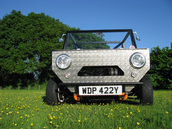

Also forgot to mention this is a readout from the last RR session with its latest engine
And some silly mods !
