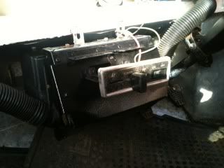

Mk3 Scamp update - Page 3 7a64fa2b
add one cut up Mini heater box and bolt to the front job done for now

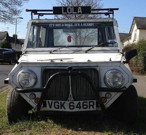

Update for Lola as it's been a very long time!!
Mk3 Scamp update - Page 3 IMG_2370
Mk3 Scamp update - Page 3 64c1d51e-d3ed-4e1f-b194-948e93c6094a

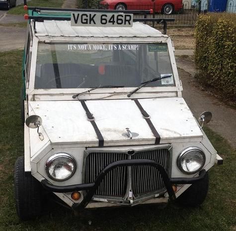

This was the test fitting of Lola's new grill (Rover P4 grill upside down)

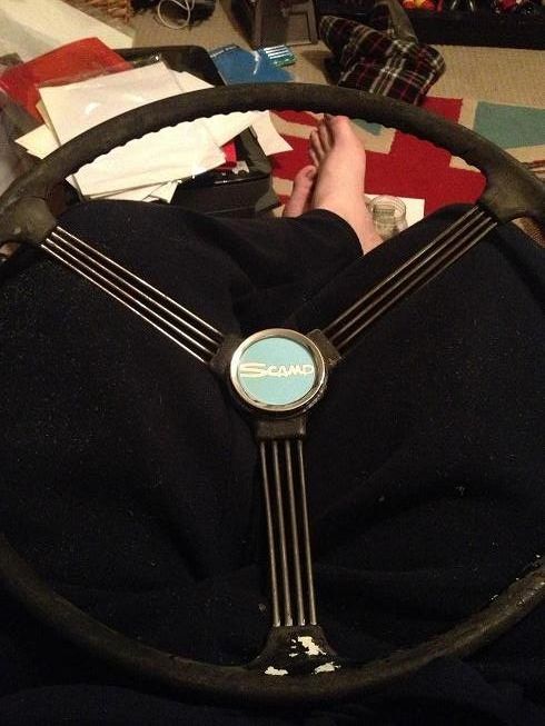

New steering wheel (possibly Morris Minor or MG Magnette!)

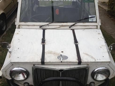

Bonnet straps and bonnet emblem (from a Morris 12)

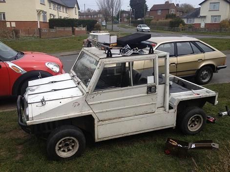

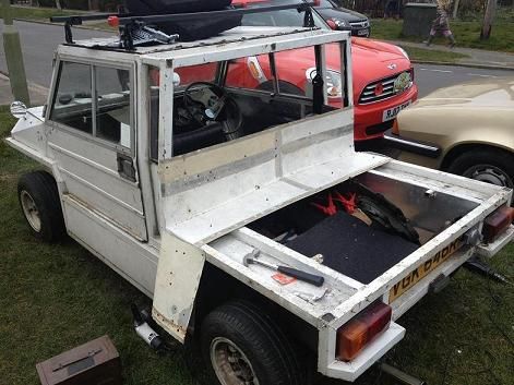

Mk3 Scamp update - Page 3 IMG_2566
it begins, first time I've ever cut a big chunk off a car!!
Mk3 Scamp update - Page 3 IMG_2567

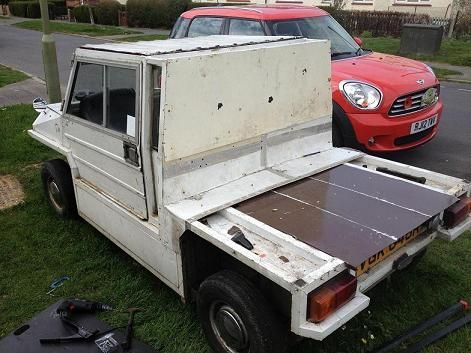

Mk3 Scamp update - Page 3 IMG_2619
rear of cab (Defender 110 sides) and a bootlid of sorts made from bits of old trailer tent. This will be hinged eventually giving a little storage.

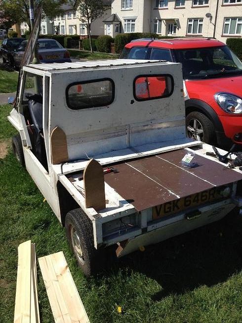

the "Tombstones" will form the structure for the wooden slats

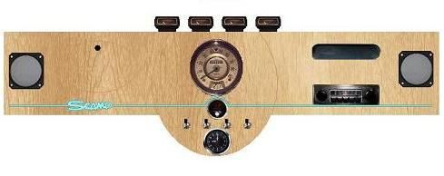

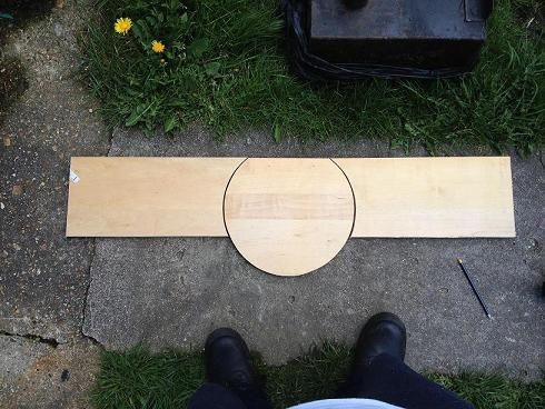

Mk3 Scamp update - Page 3 IMG_2633
mock up of the dash and the basic shape cut. That's where I am at the moment, more updates as they happen Smile

Looking good! Think I'll have to get one of those windscreen stickers Smile
